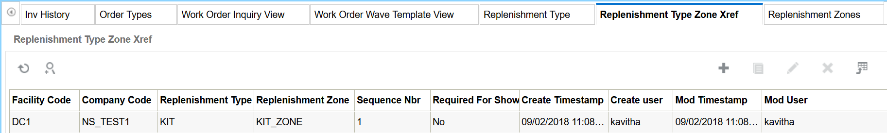

    - From the Replenishment Type UI, create a Replenishment Type for kitting.
- Create a Replenishment Zone for kitting.
- Tie the Replenishment Type with the Replenishment Zone.

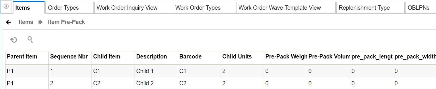

- Parent and child items need to be pre-defined along with the pre-pack
                            ratio.
