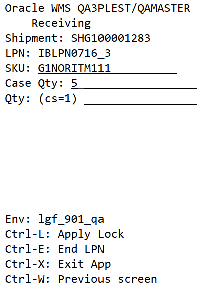

Screen Flow when confirm-uom-qty is Configured as Prompt per Sku per LPN
- When the screen parameter “qty-uom” is configured as Cases or
                                Packs and the screen parameter “confirm-uom-qty” is
                            configured as Prompt per Sku per LPN, the case/pack qty is
                            editable on the SKU scan screen.
- After scanning the SKU, the case/pack qty field is populated with std case/pack qty from item master. If you change the case/pack qty, the new value is retained for the SKU for the LPN. You will not be allowed to change the std case/pack qty of the SKU for the same LPN.
- If you scan a SKU that has std case/pack qty configured as 0 in item master, you will be allowed to change the case/pack qty with a value greater than 0.
- You are allowed to change the case/pack qty even in SKU scan mode. If you change the case/pack qty, the new value is retained for the SKU for the LPN. You will not be allowed to change the std case/pack qty of the SKU for the same LPN.
- If the SKU is batch/expiry/attribute tracked, then you will be able to edit the case/pack qty after capturing all the inventory attributes.
