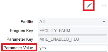

- Search for the parameter key MHE_ENABLED_FLG.
- Click Edit, and set the Parameter Value to Yes.

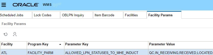

- For the facility parameter ALLOWED_LPN_STATUSES_TO_MHE_INDUCT set up the value with all of the LPN statuses that are used in MHE.
Allowed statuses include the following:
QC,IN_RECEIVING,RECEIVED,LOCATED,RESERVED,PARTLY_ALLOCATED,ALLOCATED,OUTBOUND_READY,IN_PICKING,PICKED,IN_PACKING,PACKED,LOADED,CONSUMED,SHIPPED,DELIVERED,LOST,CANCELLED
