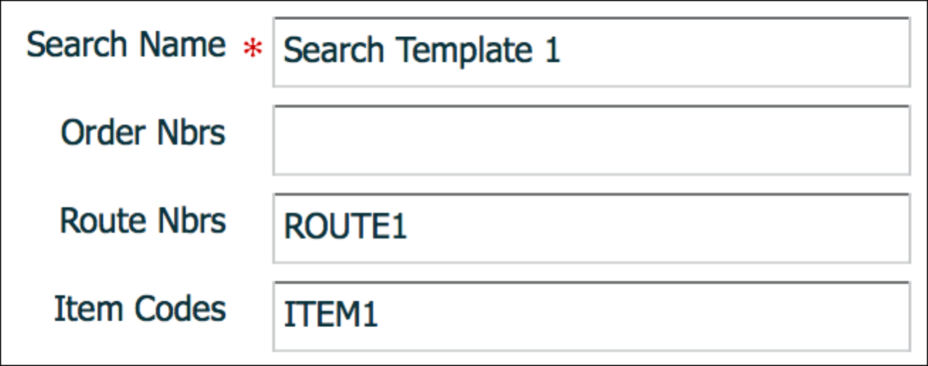

In example 1, “Search Template 1” will filter all orders with route number “ROUTE1” and that only contain SKU “ITEM1”.

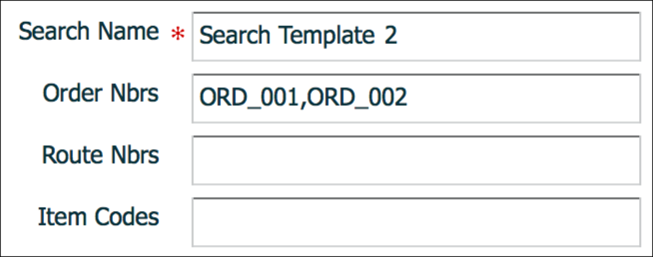

In example 2, “Search Template 2” will filter orders that have order numbers “ORD_001” and “ORD_002”. In other words, Wave Templates with this search template selected will only attempt to allocate these two orders.

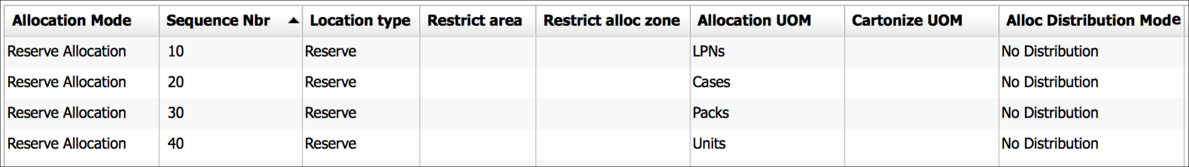

Step 2: Create an Allocation Mode
Allocation Modes are used to define how the inventory should be allocated in terms of the different allocation UOMs.
- Create a new Allocation Mode with the Create button.
- Enter its details with the Details button.
- Create the sequence of allocation UOMs desired for the Wave Template. See example below.

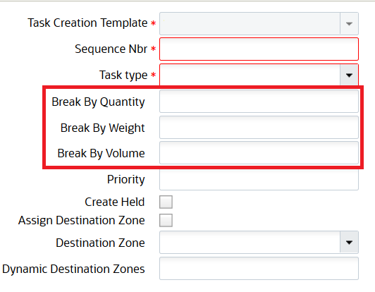

| Break By Quantity | Specify the break by value in Quantity. The user configured break by value will be considered for grouping the tasks based on the allocation mode and task template configured for the wave. Users can now break the tasks by configuring break by quantity value in task creation template. |
| Break By Weight | Specify the break by value in Weights. Users can now break the tasks by configuring the break by weight value in the task creation template. |
| Break By Volume | Specify the break by value in Volume. Users can now break the tasks by configuring the break by volume value in the task creation template. |

Break the Task via Break By Parameter
The allocations in a wave are added to a task until one of the value - quantity, weight, and volume mentioned in break by parameter has reached the value. Once the condition is satisfied, the system creates a new task for the next allocation in sequence and continues to verify the tasks are created for all allocations in a wave.
For example, If break by quantity is configured as 80, and there are three allocations in sequence with Qty: 50, 60 and 40, the first two allocations with Qty 50 and 60 are added to the first task and then the third allocation with Qty 40 is created as a second task.
- From the Task Creation template UI. Select the template and click details icon.
- The Details page opens > Click Create (+) icon.
- Enter the break by values in the respective field. By default, these fields are set
with value 0 or blank, and supports decimal values greater than or equal to
zero”.Note: For Template Type = Regular, you can save the record by populating numeric values in the new fields. While creating, the entered "Break By Weight" & "Break By Volume" rounds-off based on the max weight, volume and dimension decimal precision value configured in Decimal settings for the user logged in company.
- Click Save.

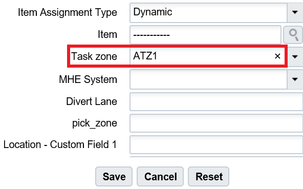

To add a Task Zone to a location:
- Go to the Task Zone screen and create a new Task Zone.
- Go to the Locations screen, select the desired location and click edit.
- In the “Task Zone” field, select the Task Zone that you added in step 1.
For example, if there is a Drop Zone location “DZ1” with Destination Zone “ATZ1”, there will be the following Task Template configuration:
This means that at the end of every “Reserve Units” Task, you are prompted to move the picked LPNs into a “DOOR_DROP” location – which in this case is location “DZ1”.

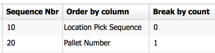

Ordering Criteria
The Ordering Criteria allows you to determine the break logic for each Task. For example, if there is a criteria for “Break by Order Nbr = 1”, WMS will create a new Task for every unique Order number in this Task Type.
- Select the Task Type record and click “Ordering Criteria”.
- Create a new breaking rule for this Task Type by clicking the Create () button.
- Enter the sequence number, select the logic criteria and the ‘break by’ value.
- Click Save.
Example:
screen
- Location Pick Sequence, Break by count = 0
This will sort the creation of Tasks in order of the allocation’s Location Pick Sequence.
- Pallet Number, Break by count = 1
This will create a new Task for every Pallet that is allocated. This may be used in cases where the picking equipment does not allow users to pick multiple pallets at a time.
