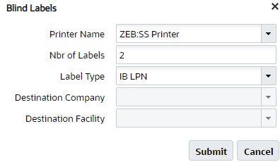

| Blind Labels | Allows you to print blind labels by selecting the number of labels, Label type (either IBLPN, OBLPN or Pallet), Destination company, and Destination facility. |

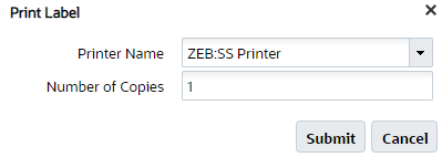

Printing Labels in the IBLPNs UI
You can distinguish and change printers depending on warehouse location and activity.
- After you select the IBLPN record, click the Print Label action button in the IBLPN Inquiry UI > Select the printer from the Printer Name drop-down.
- Enter the number of copies (labels) you would like to print per LPN and click
Submit.
- If "Number of copies" is greater than 1, the system will complete printing for the first IBLPN, and then move to the next IBLPN.
- If you do not select a printer from the list of printers, and proceed with "Submit", then your default printer will be selected to print the label.
- The sequence of printing the labels will be in the sequence displayed in the IBLPN Inquiry screen.
- A confirmation message will display to let you know that printing is complete.
You can also select a printer and number of label copies when you need to print Blind Labels via the Blind Labels action button:
