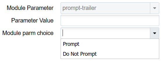

- Go to the “Screen Configurations” view.
- Select the RF receiving module and click Details. This will display all the parameters for the selected RF module.
- Select the parameter “prompt-trailer”. Click Edit.
From the “Module parm choice” drop-down, select the desired option.
        The screen parameter “prompt-trailer” can be configured with one of the following options:
- Prompt: Trailer prompt is displayed. You have the option to either scan the trailer or skip it.
- Do Not Prompt: Trailer prompt is not displayed. In this case, even if the screen parameter “validate-trailer-on-load” is configured as Validate Trailer, the trailer number will not be validated. However, the trailer nbr associated with the shipment will be copied to the Received Trailer Number field of the received LPNs.
