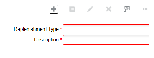

Before you configure the Replenishment Type on the item facility, you need to define the type.
Define the replenishment type from the Replenishment Type UI > Click Add
and enter the details as below:
To configure the Replenishment type on the UI:

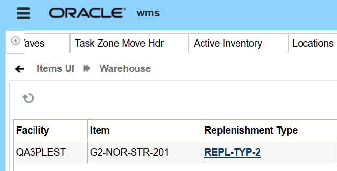

- Go to the Item UI > Click the Warehouse icon.
- Select the item or Click Add to open the item configuration pane.
- Select your Replenishment Type from the drop-down menu and click
Save.
