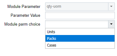

Configuration Steps
        - Go to the “Screen Configurations” screen.
- Select the RF Recv [lpn] Load and click on Details (). This will display all the parameters for this RF module.
- Select the parameter “qty-uom” click Edit ().
- In the “Module parm choice” drop-down menu, select the desired
                            UOM.

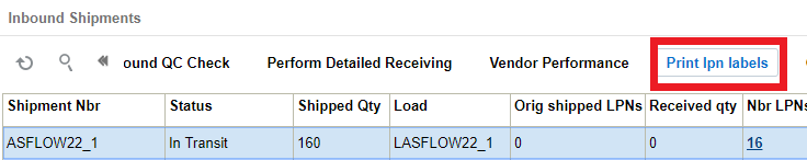

Oracle WMS Cloud also allows ‘smart receiving’, which is when LPNs are defined in the ASN
            prior to receipt:
        - Go to the “Inbound Shipments” screen.
- Select the ASN and click on “Print LPN Labels”. This will print all the
                    cartonized LPNs in the ASN.
- Enter the RF module for receiving.
- Scan the LPN; the system will recognize the LPN’s contents and ask the user to
                    confirm its contents. Press Ctrl-A to proceed.

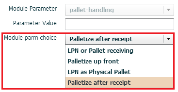

Configuration for Palletization during Receipt
For receiving flows with palletization, the receiving RF module must be configured
            appropriately. There are four types of palletization during receipt:
        - LPN or Pallet level receiving
- Palletize up front (before scanning LPN)
- Palletize at end (after scanning LPN)
- Receive LPN as physical pallet (the LPN is treated as a pallet in the system)
To Configure on the UI
        - Go to the “Screen Configuration” screen.
- Select the receiving RF module (rf.inbound.cwrfrecvlpnshpmt) click on Details ().
- This will open a window with all the RF module’s parameters. Select parameter pallet-handling and click Edit ().
- Click on the “Module parm choice” drop-down menu and select the appropriate
                        palletization mode.
