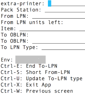

- Enter the “Repack” RF module.
- Depending on which parameters are activated, the RF displays a different number of fields. The figure below shows all of the possible fields for the RF.
Figure 298: The repack RF screen
- Extra-printer: Scan the laser printer barcode (this is to print the packing slip)
- Pack Station: Scan the Packing Station in which the OBLPN will be packed.
- From LPN: Scan the OBLPN to pack from (this is the OBLPN in “Picked” status).
- From LPN units left: This field displays the number of units there are left to pack from. As the user scans each unit from the “From LPN”, the quantity will decrease.
- Item: Scan the item code.
- To OBLPN: This is the OBLPN that you will pack to (also known as the “final
OBLPN”).
- If the allocation is not cubed, WMS will not prompt an OBLPN number. You will manually choose the LPN to pack to, followed by the OBLPN Type.
- If the allocation is cubed, WMS will pre-assign an OBLPN with the OBLPN
number and LPN Type.
- When the “From LPN” is emptied, the RF cursor will return to the “From LPN” field and prompt you for another OBLPN to pack from.
