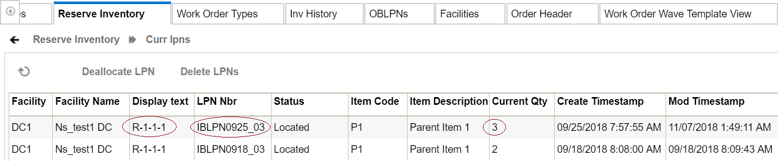

Ensure that there is enough inventory for parent P1 in the facility. In this example,
            there is one LPN in a reserve location with three units of P1.
The same Wave Template that was described under Make to Stock flow can be used, ensuring that the Wave Search criteria is modified to pull the new Work Order. When the wave is run, it allocates one LPN from reserve which has three units of P1.
A task is created to move the LPN from a reserve location to an assembly location.
