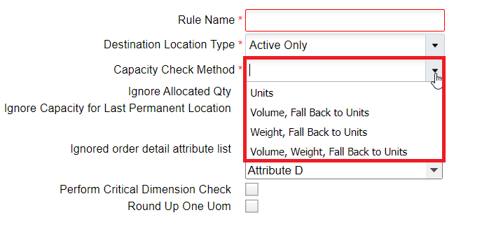

- You need to configure the Replenishment Type on the item facility and a
                search sequence by Replenishment type to Replenishment Zone configuration.
                This provides flexibility to set similar items together while assigning them to
                dynamic locations. - Define capacity checks to assess how much can be replenished.
- On assessing the capacity, the system performs the capacity check based on
                        the configuration you select. You can choose to perform capacity check based
                        on any of the following methods:
- Upon assessing the capacity for reserve locations to perform replenishment, the system performs max volume and weight check, max units, and max LPN's check.
