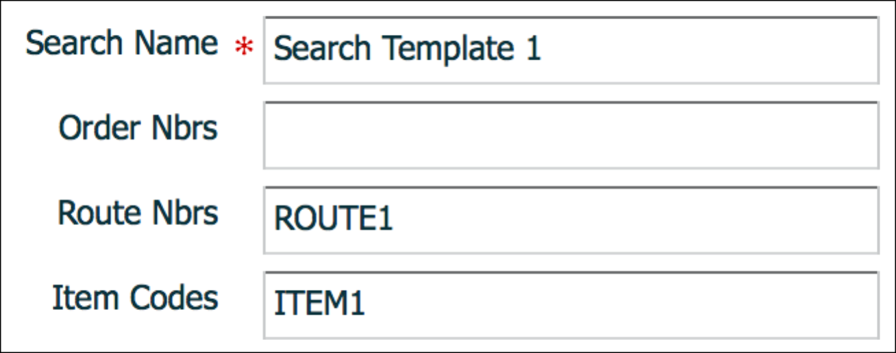

creating wave templates example 1
In example 1, “Search Template 1” will filter all orders with route number “ROUTE1” and that only contain SKU “ITEM1”.

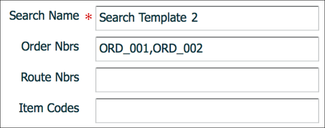

creating wave templates example 2
In example 2, “Search Template 2” will filter orders that have order numbers “ORD_001” and “ORD_002”. In other words, Wave Templates with this search template selected will only attempt to allocate these two orders.

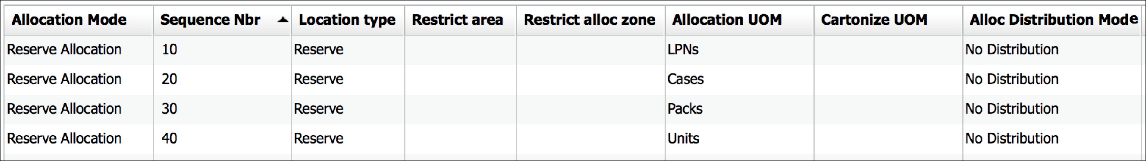

  3. Create the sequence of allocation UOMs desired for the Wave Template. See example below.
Sample Allocation Mode Configuration

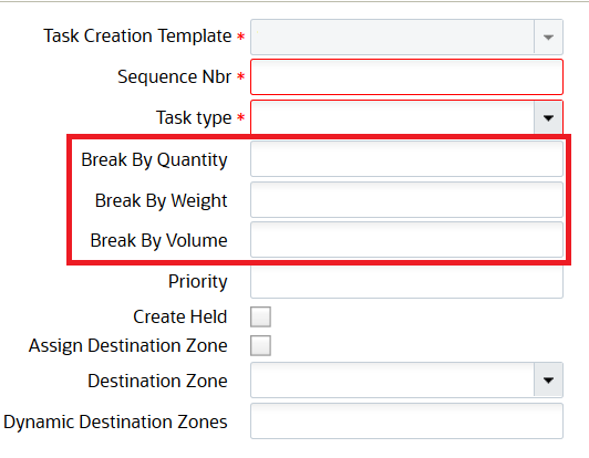

Break By Quantity Specify the break by value in Quantity. The user configured break by value will be considered for grouping the tasks based on the allocation mode and task template configured for the wave. Users can now break the tasks by configuring break by quantity value in task creation template.
Break By Weight Specify the break by value in Weights. Users can now break the tasks by configuring the break by weight value in the task creation template.
Break By Volume Specify the break by value in Volume. Users can now break the tasks by configuring the break by volume value in the task creation template.

Break the Task via Break By Parameter
The allocations in a wave are added to a task until one of the value - quantity, weight, and volume mentioned in break by parameter has reached the value. Once the condition is satisfied, the system creates a new task for the next allocation in sequence and continues to verify the tasks are created for all allocations in a wave.
For example, If break by quantity is configured as 80, and there are three allocations in sequence with Qty: 50, 60 and 40, the first two allocations with Qty 50 and 60 are added to the first task and then the third allocation with Qty 40 is created as a second task.
Note: To configure the break by value, do the following:
  1. From the Task Creation template UI. Select the template and click details icon.
  2. The Details page opens > Click Create (+) icon.
    Break By Value
  3. Enter the break by values in the respective field. By default, these fields are set with value 0 or blank, and supports decimal values greater than or equal to zero”.
    Note: For Template Type = Regular, you can save the record by populating numeric values in the new fields. While creating, the entered "Break By Weight" & "Break By Volume" rounds-off based on the max weight, volume and dimension decimal precision value configured in Decimal settings for the user logged in company.

Task Breaks by Quantity, Weight, Volume
The following use case provides an outline on how the tasks are broken based on break by values:
Break by Quantity
Use Case - 1: If you have a allocation with allocated quantity 20 in task creation template. The Break By Quantity =10, and Break By Weight/Break By Volume = null/empty, the task is created as follows:
LPN Item Location Order Allocated Qty Task
LPN10 Item10 Loc10 Ord2 20 Task0005
Even though the allocated quantity is twice that of the Break by Quantity, the system creates only one task as the allocation cannot be broken further into multiple tasks.
Use Case - 2: If you have three allocations with the allocated quantity as 4,4, and 3 and in task creation template, the Break By Quantity = 5, and Break By Weight/ Break By Volume = null/empty, the tasks is created as follows:
LPN11 Item11 Loc1 Ord3 4 Task0010
LPN21 Item11 Loc2 Ord3 4 Task0010
LPN31 Item11 Loc3 Ord3 3 Task0011
The Task0010 can accommodate only 5 units (break by Qty =5), but the first allocation does not exceed the break by value and on including the second allocation, the total quantity for task exceeds break by quantity. Because, the system does not split the allocation further, the second allocation is included in Task0010 and the total quantity in Task0010 = 8 (4+4).
Break by Weight and Volume
Example
LPN Item Quantity Weight Volume
LPN1 Item1 10 1000 10000
LPN2 Item1 10 1000 10000
When order (Order1) is for Item1, the Quantity = 20, and the above LPNs are available in the system. When you run the wave and the Break by Quantity is 20, both the allocations will be grouped into a single task because the break by condition is not satisfied:
Example
LPN Order Allocated Quantity Task
LPN1 Order1 10 Task00001
LPN2 Order1 10 Task00001
When the Break by Quantity is 20 and the Break by Weight is 1000, two separate tasks will be created for allocations because the Break by Weight is satisfied for both allocations:
Example
LPN Order Allocated Quantity Weight Task
LPN1 Order1 10 1000 Task00002
LPN2 Order2 10 1000 Task00003
Note: The grouping of tasks happens at the allocation level (meaning a single allocation will not be broken into two tasks even if the break by quantity/weight/volume is satisfied within the allocation).
Note: There are cases where any one among break by quantity/break by weight/break by volume fields need not be considered as criteria for breaking tasks, in that case, you can configure values for the respective fields as zero while defining task template details, and the break by criteria won't be considered while creating tasks.

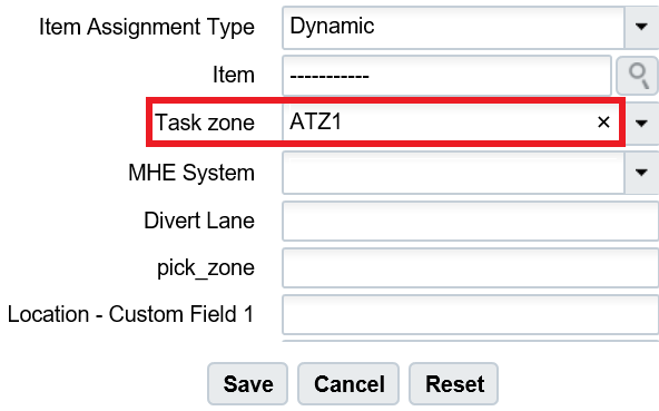

To add a Task Zone to a location:
  1. Go to the Task Zone screen and create a new Task Zone.
  2. Go to the Locations screen, select the desired location and click edit.
  3. In the “Task Zone” field, select the Task Zone that you added in step 1.
For example, if there is a Drop Zone location “DZ1” with Destination Zone “ATZ1”, there will be the following Task Template configuration:
Adding a Task Zone from Location UI
This means that at the end of every “Reserve Units” Task, you are prompted to move the picked LPNs into a “DOOR_DROP” location – which in this case is location “DZ1”.

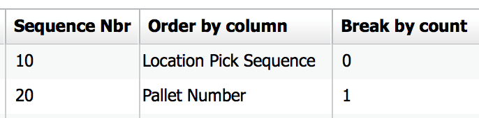

Ordering Criteria
The Ordering Criteria allows you to determine the break logic for each Task. For example, if there is a criteria for “Break by Order Nbr = 1”, WMS will create a new Task for every unique Order number in this Task Type.
  1. Select the Task Type record and click “Ordering Criteria”.
  2. Create a new breaking rule for this Task Type by clicking the Create () button.
  3. Enter the sequence number, select the logic criteria and the ‘break by’ value.
  4. Click Save.
Example:
creating wave templates break by countscreen
  1. Location Pick Sequence, Break by count = 0
    This will sort the creation of Tasks in order of the allocation’s Location Pick Sequence.
  2. Pallet Number, Break by count = 1
    This will create a new Task for every Pallet that is allocated. This may be used in cases where the picking equipment does not allow users to pick multiple pallets at a time.
