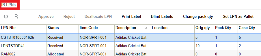

iblpns screen
Action Button Description
Accept If the LPN is Marked for quality control, you can accept it here.
Reject If the LPN is Marked for quality control, you can reject it here.
Deallocate LPN If the LPN is allocated, you can deallocate here.
Print Label This button prints the LPN label according to the label template set up in Label Template View (label type IB Container)
Blind Labels Allows you to print blind labels by selecting the number of labels, Label type (either IBLPN, OBLPN or Pallet), Destination company, and Destination facility.
Change Pack QTY Allows you to change the pack quantity of the selected IBLPN.
Set LPN as Pallet Allows you to Set LPN as Pallet.
Unset LPN as Pallet Allows you to unset LPN as pallet.
Modify Qty Allows you to modify the LPN quantity, and you must provide a reason code.
Locate LPN Locates the LPN. If the flag capacity check is enable, the system will make sure that the LPN fits the location according to max volume, max units, and max weight.
Generate MHE Distribution Msg It generates the TO_MHE_DISTRIBUTION_INFO message.
Generate MHE IB LPN Info Msg It generates the TO_MHE_IBLPN_INFO message.
Mass Update Attributes Allows you to do a mass update for Inventory attributes A-O and Putaway Type. Updates all the records shown in the page, so it’s a good idea to limit your search. It will first tell you the number of records that will be updated.
Print UOM Label Allows you to print a UOM Casel label or UOM Pack label fo the LPN selected.
Update LPN Type Allows you to update the LPN type of the selected LPN.

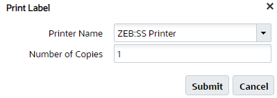

Printing Labels in the IBLPNs UI
You can distinguish and change printers depending on warehouse location and activity.
  1. After you select the IBLPN record, click the Print Label action button in the IBLPN Inquiry UI > Select the printer from the Printer Name drop-down.
  2. Enter the number of copies (labels) you would like to print per LPN and click Submit.
    Print Label
    • If "Number of copies" is greater than 1, the system will complete printing for the first IBLPN, and then move to the next IBLPN.
    • If you do not select a printer from the list of printers, and proceed with "Submit", then your default printer will be selected to print the label.
    • The sequence of printing the labels will be in the sequence displayed in the IBLPN Inquiry screen.
    • A confirmation message will display to let you know that printing is complete.

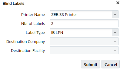

You can also select a printer and number of label copies when you need to print Blind Labels via the Blind Labels action button:
Blind Labels
