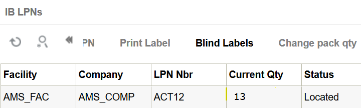

  1. Your IBLPN consist the item ACT with current qty =13.
    Note: You need to set the item’s putaway type to Active 1, so that the same SKU will appear in the IBLPN.
    Split LPN IBLPN

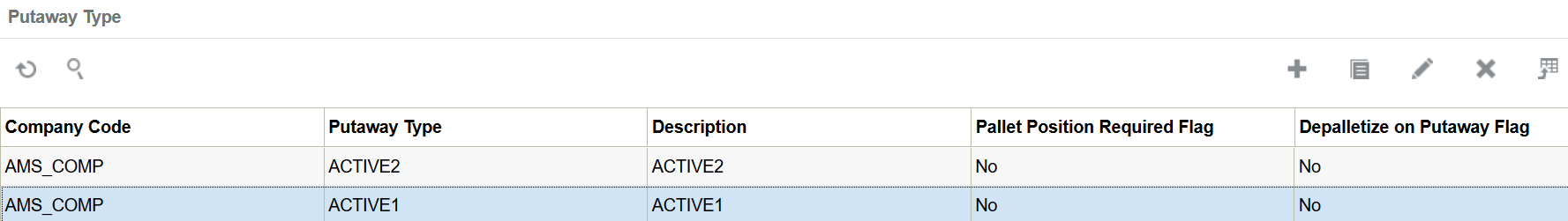

  2. Go to Putaway Type UI and define 2 putaway type ACTIVE1 and ACTIVE2.
    Putaway Type

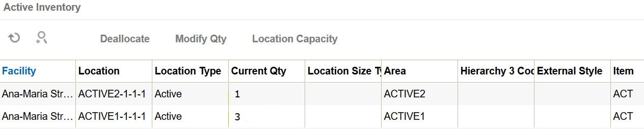

  5. Check if the item ACT is available in the 2 location in the active inventory UI:
    Putaway Type Example

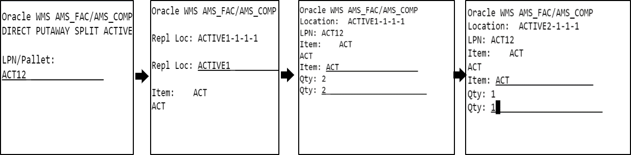

  6. Invoke the Direct Putaway transaction, the system allocates maximum units for each location.
    Putaway Transaction
    Note: On receiving the IBLPN, the putaway type Active 1 appears automatically.
  7. You can choose to putaway the remaining units from the IBLPN into the location you choose.

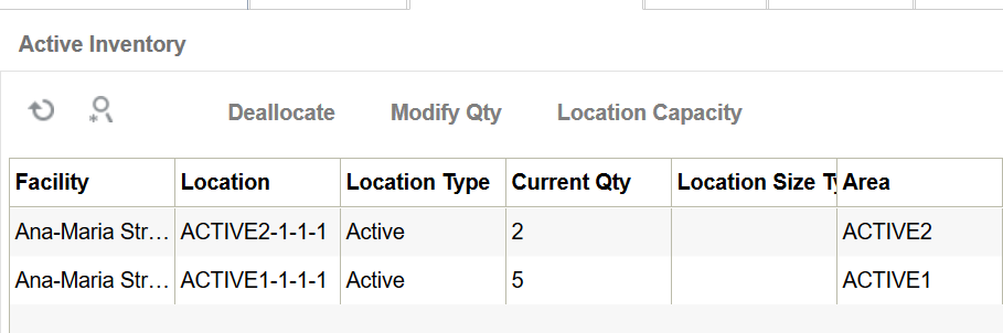

  8. To verify, go to Active and Reserve Inventory UI to view the allocation and current qty.
    Active Inventory
