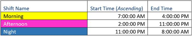

For example, let’s say that the following three shifts have been configured in WFM. User1 has a default shift defined as “Afternoon” configured in the User Master.
On day 1, if User1 clocks-in to the facility at 6:00 AM, the shift is determined as “Morning”. On day 2, if this user clocks-in to the facility at 8:00 AM, the shift is again determined as “Morning”. On day 3, if this user clocks into the facility at 7 PM, the shift is determined as “Night”, because 7 PM is closest to the “Start Time” of 11:00 PM."
In the table above (5 hours have already passed since shift “Afternoon” has started).
In other words, although User1’s default shift is defined as “Afternoon”, the actual shift is determined based on the time at which User 1 clocks into the facility.
