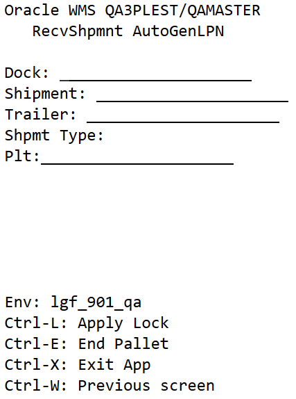

- On the first screen, after entering the inbound shipment and pallet nbr, you are
taken to the SKU scan screen.
- On the SKU scan screen, the Ctrl-E key will activate “End Pallet”.
- If you hit Ctrl-E, the system displays the message “End pallet
<plt nbr>?”
If you accept the message, the system ends the pallet and takes you back to the first screen and prompts you for a Pallet.

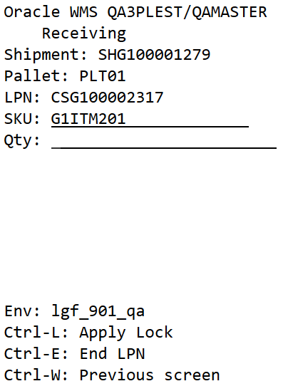

- If you scan a SKU, an LPN nbr will be auto-generated. The Ctrl-E
control key is now displayed as End LPN.
- If you press Ctrl-E, the system displays the message “Nothing to receive.”
- If you enter the quantity, press tab/enter and then Ctrl-E, to end the LPN. The LPN field is now blank and Ctrl-E is displayed as End Pallet.
In general, in the SKU prompt screen if the pallet number is populated and the LPN is blank, then Ctrl-E is displayed as End Pallet. If the pallet number is populated and LPN is populated, then Ctrl-E is displayed as End LPN.
