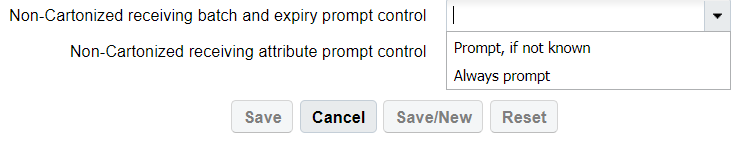

To configure the non-cartonized receiving for batch, expiry and inventory attribute prompt controls:
  1. Go to IbShipmentTypeView screen and click Create button.
  2. Enter the shipment details and populate the desired prompt control:
    • Non-Cartonized receiving batch & expiry prompt control: Blank (Default behavior)/ Prompt, if not known/Always prompt.
    • Non-Cartonized receiving attribute prompt control: Blank (Default behavior)/ Prompt, if not known/Always prompt.
      Note: Configuration Fields for Non-Cartonized ASN
  3. Click Save.
    Note: When Non-Cartonized Receiving for Batch number & Expiry Number /Attribute prompt control is set to Prompt, if known or Always prompt, the system does not honor any of the item property configurations for batch/expiry dates/ inventory attribute.

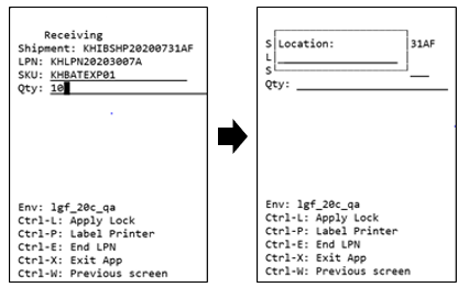

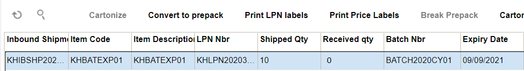

Example: Prompt for batch/expiry date for single SKU for a Non-Cartonized Shipment at the Item Level
Let’s say, you have the following ASN to be received:
Prompt for batch/expiry date for single SKU for non-cartonized

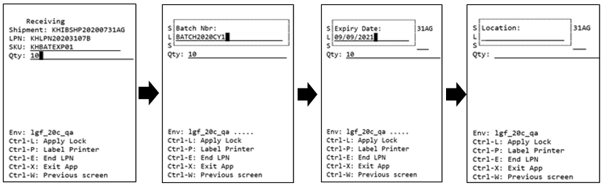

When Non-Cartonized receiving batch/expiry date prompt control = Prompt, if not know:
When Non-Cartonized receiving batch/expiry date prompt control= Always prompt
Note: On scanning an existing batch with batch master populated with an expiry date, the system will not prompt for Expiry date even if the expiry date prompt control is set to Always Prompt (either at item level or shipment type).

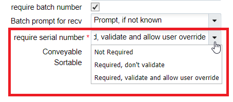

Non-Cartonized Receiving for Serial number prompt control
  1. Go to Item UI > Details. Click Edit.
  2. Enable the “required serial number” drop-down at item’s level configuration with values:

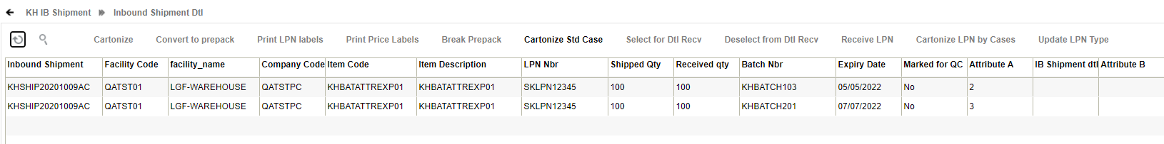

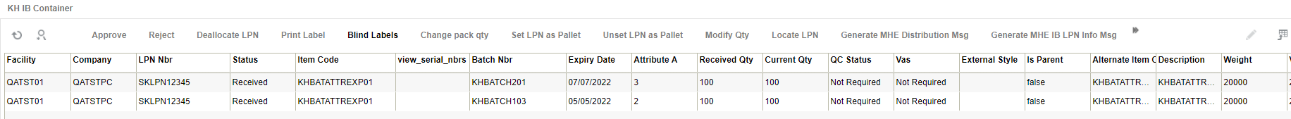

Let’s say you have the following ASN configured:
Receive Multiple batch/expiry/inventory attribute for the same SKU

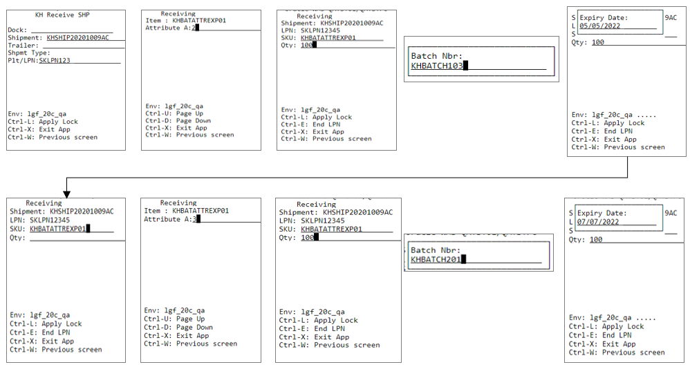

The system scans through the SKU 1 (attribute, batch and expiry) and without ending the LPN, the system loops through remaining SKUs with the same hierarchy.
Receive Multiple Inventory
Upon scanning all the SKUs in the LPN and performing CTRL+E, the system receives the SKUS and updates the shipments details in the following manner: Receive Multiple batch/expiry/inventory attribute for the same SKUReceive Multiple batch/expiry/inventory attribute for the same SKU
