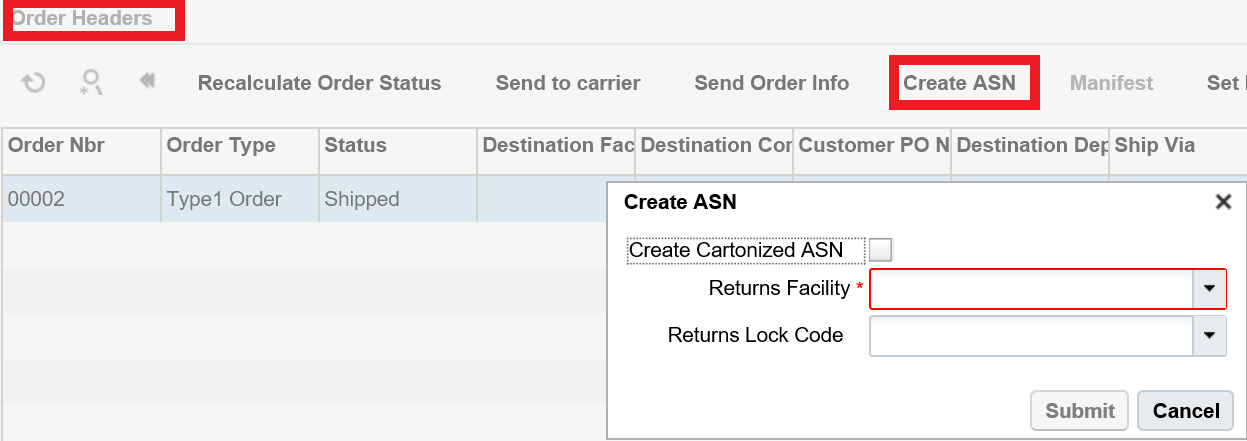

Return Whole Orders from Order Headers UI
You can receive returns from inventory that was shipped from your current facility or from a different facility from the Order Headers UI. You can search for the \shipped order , select it, and create an ASN so that later you can receive this inventory in your return facility.
This feature requires a group permission such as 'order hdr/Create ASN ' for this button so that only users with sufficient access can select it. By default, only users with an ‘ADMINISTRATORS’ or ‘MANAGEMENT’ role have access to this button. All other users will have to get the corresponding group permission enabled to be able to select this button.
To create an advanced shipment notice (ASN) for returns, go to the Order Header Screen and click “Create ASN.”
| Create ASN Fields | Description |
| Create Cartonized ASN |
The system will generate a cartonized ASN. |
| Returns Facility | Drop down with list of Facilities |
| Returns Lock Code | Drop down with list of Lock Codes which will be transferred to your newly created ASN |
The Create ASN button is only enabled if the order is in Shipped status. Once you select Create ASN, the Create ASN window appears. When you select Create Cartonized ASN, the system will generate a cartonized ASN. For more details about Cartonized ASNs. You can select the return facility from the Returns Facility (required field) drop-down. The ASN will be created from the facility you select. The Returns Lock Code drop-down gives you the option to assign your inventory Lock Code which will be transferred to your newly created ASN.

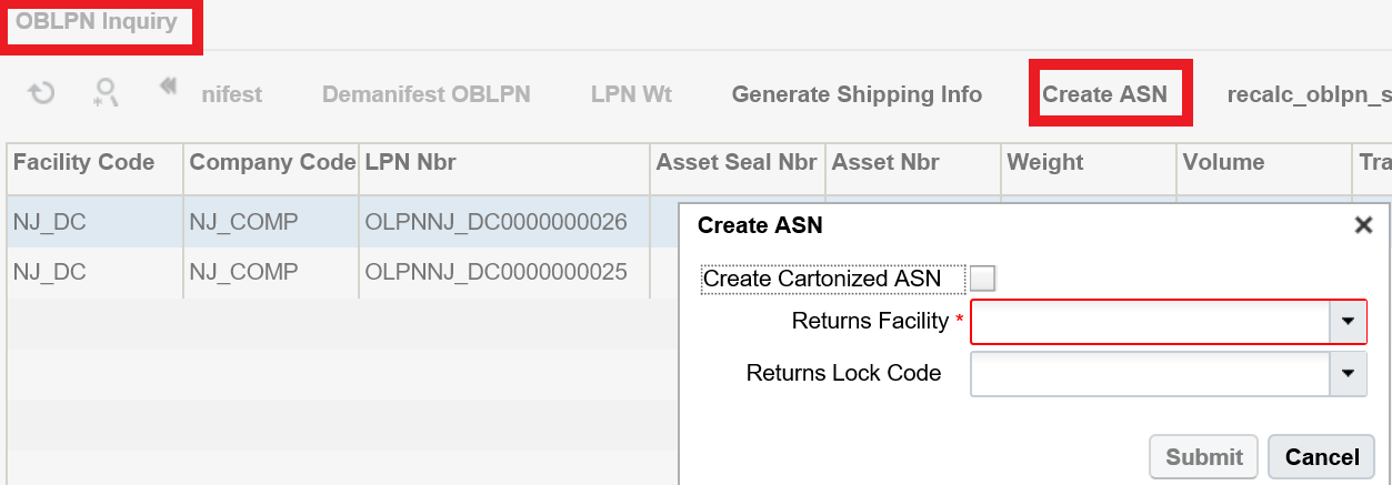

Return Items from the OBLPN Inquiry UI
If you need to return a specific inventory from your order, you can do this from the OBLPN Inquiry UI via the Create ASN button. You can access the Create ASN action button by selecting one or more OBLPNs. However, when you select one or more OBLPNs which are not in shipped status, then Create ASN will be disabled. The same logic applies for creating an ASN from the OBLPN Inquiry as it does from the Order Headers UI.

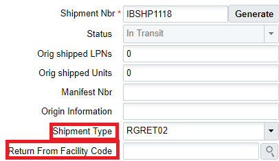

- The “Return From Facility Code” field (on the create pane of the Inbound
Shipment UI), features an advanced look up option to find the customer,
distribution center, or store from where the shipment was returned.
- “Return From Facility Code” is enabled only if the Shipment Type on the shipment has “Capture Returns Information” configured as Yes in the Shipment Type UI. In this example, Shipment Type RGRET02 has been configured with “Capture Returns Information” as Yes, which has enabled the “Return From Facility Code” field).

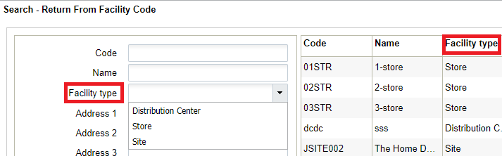

- Once you select the advanced look up option, the following screen appears,
and displays a facility type of “DC”, “Store”, or “Site”. Depending on where
the shipment is returned from, choose the appropriate facility type. If the
return shipment is from a customer, then choose “Site” as the facility
type.

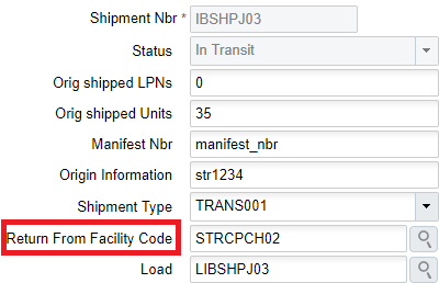

- When a Transfer Shipment is created for a load that is shipped from one facility to another, if the determined Shipment Type has “Capture Returns Information” configured as Yes, then the “return from facility code” is populated on the Transfer Shipment.
