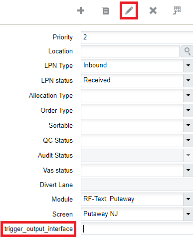

You can generate LPN Inventory and OBLPN Shipping information from the MHE Route Instruction Configuration UI. This feature allows customers to send information to the MHE system.
For example, the MHE system can take this information and use it to print a shipping label. If the Outbound LPN is subject to Route Instruction check, after user perform induction via RF or API, the system will check the configuration and generate the LPN_INVENTORY message or the OBLPN_SHIPPING_INFO.
From the MHE Route Instruction Configuration screen – update the trigger_output_interface field with either LPN_INVENTORY message or the OBLPN_SHIPPING_INFO
