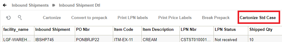

- Go to the “Inbound Shipment” screen.
- Select the ASN that will be cartonized based off of the standard case quantity,
and click on the ASN detail button.
- Assign LPNs to ASN details for each pallet or full case by selecting an ASN details by clicking on the “Cartonize Std Case” button.
- Oracle WMS Cloud will then cartonize the ASN detail line selected based off of
the standard case quantity found in the item master.

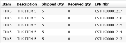

Example:
Suppose an ASN Detail contains a shipment for Item THK5, quantity 25. In the Item Master, THK5 has the “Standard Case Quantity” defined as 5.
Clicking the “Cartonize Std Case” button will generate 5 LPNs of 5 units each:
