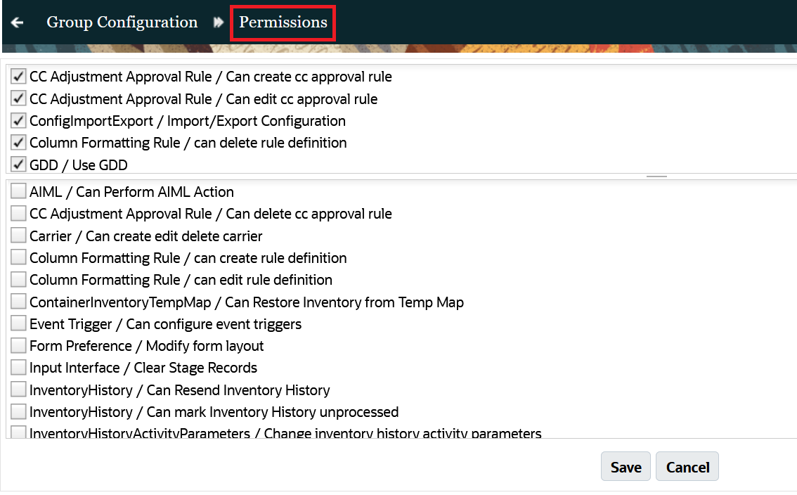

Permissions
From the Group Configuration UI, click Permissions to view the available permissions for Cycle Count Adjustment Rule and to set group permissions.
