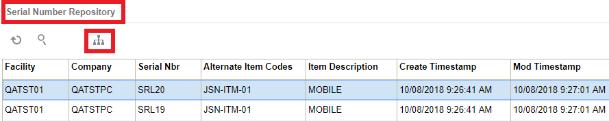

Serial Number Repository View
This screen displays all Serial Numbers for all items in the current facility.

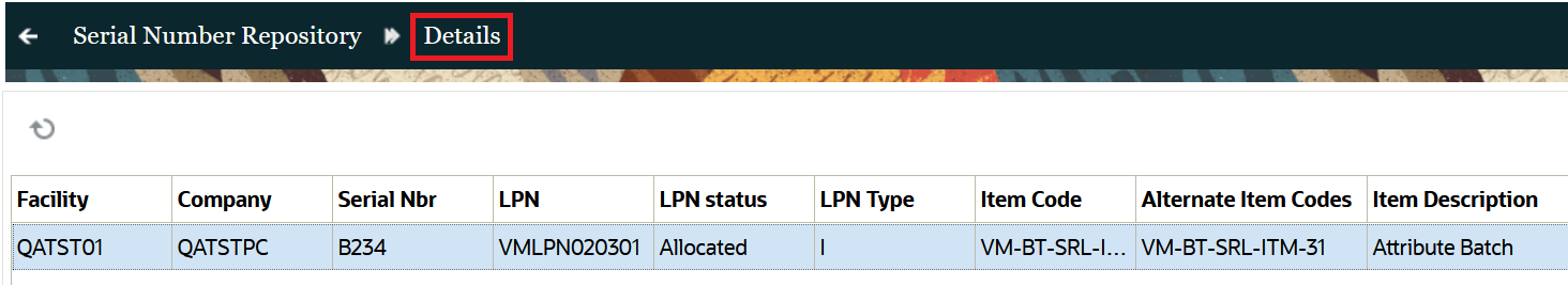

You can also drill down to the serial number record’s details () to view the inventory associated to it:
If the serial number is associated to inventory, the detailed view indicates the LPN’s status (Located, Allocated, Packed, and so on).
You can view records with serial number discrepancies by filtering the Inbound Container View and Outbound Container View UI with the 'Has serial number discrepancy' filter option. You can also view all the records with serial number discrepancies from the Serial Number Repository View UI.
- Go to Serial Number Repository View UI
- Click the Serial Number Discrepancy View action button to view all the record with serial number discrepancies within the logged in facility are displayed on the UI screen. The Serial Number Discrepancy View UI displays serial discrepancy records from IB Container, OB Container, and Active inventories.
