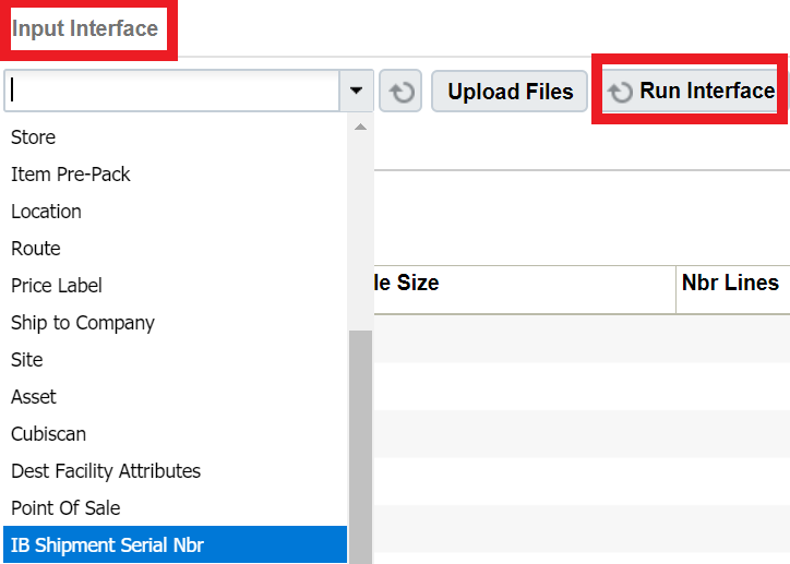

Once you verify that all necessary information is in the system, follow these steps to upload your serial numbers:
  1. Go to the Input Interfaces screen.
  2. Select IB Shipment Serial Nbr from the drop-down, upload the interface file, and click “Run Interface”.
    IB Shipment Serial number
  3. If everything was done correctly, the system prompts the message “Status: Interface Completed”. From the the IB Shipment Serial Number screen, click OK and verify that the serial numbers were successfully uploaded.
