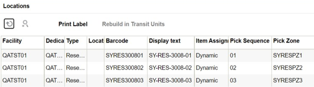

- First, you will create three Reserve locations. Each reserve location belongs to a different pick Zone:

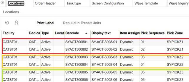

- Then, create six Active Locations:
There are three Pick Zones. In each Pick Zone there are two Locations:

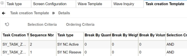

In the Task Creation Template UI, no Selection Criteria has been configured, and the Ordering Criteria has been set to Order Header, Order Number with a Break by Count = 1 in Reserve and Active locations.

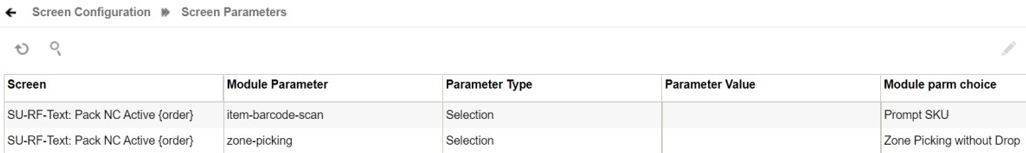

For RF Pack NC Active, we have configured the zone-picking module parameter with the Zone Picking without Drop parameter choice.

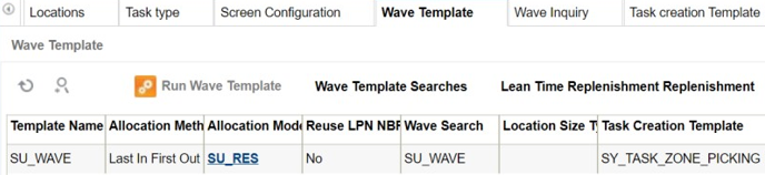

In the task creation template in the wave, the Allocation is from Reserve and Active.
- Run the wave template for all three orders with the above data setup.
