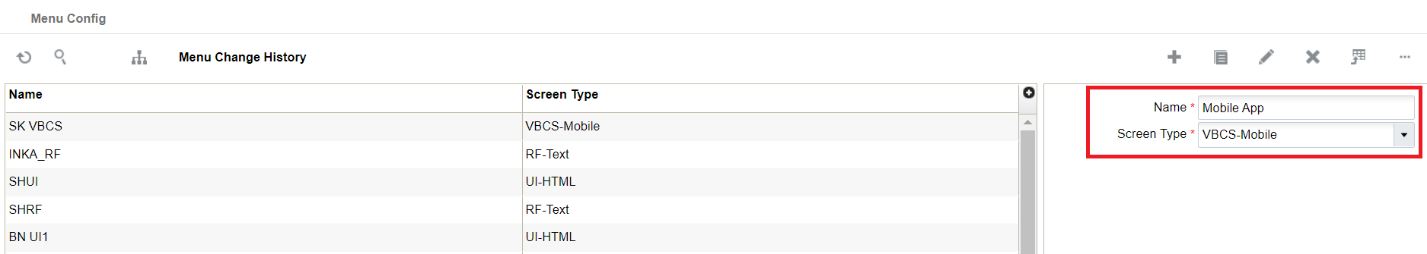

To setup Menu Configuration, do the following:
- From the Menu Configuration UI, click the "+" icon button at the top right of the Menu UI screen.
- Enter the Name and select the Screen Type = "VBCS-Mobile" for the Mobile
Application.

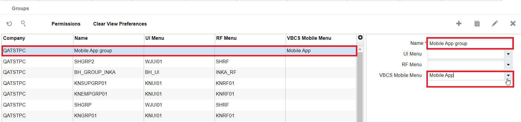

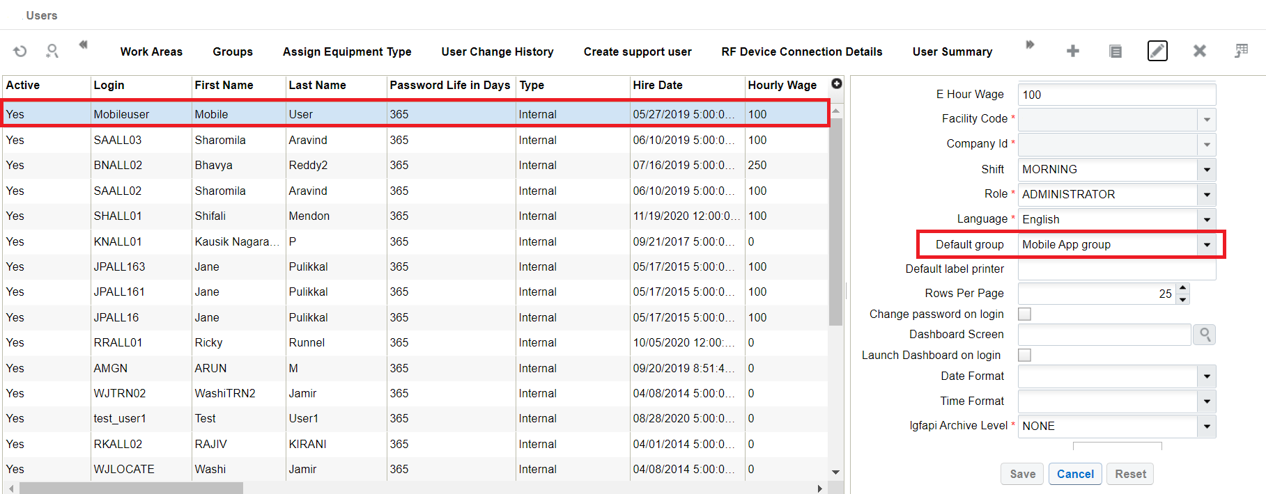

To assign the Menu to the group, go to the Group Configuration UI > click the VBCS Mobile Menu > add the Menu (here,Mobile App) to the existing or a new group.
Create a user with your preferred group name (for example, Mobile App) or you can also update an existing user with the group. Assign the default group to the VBCS-Mobile (here, Mobile App) menu you created.

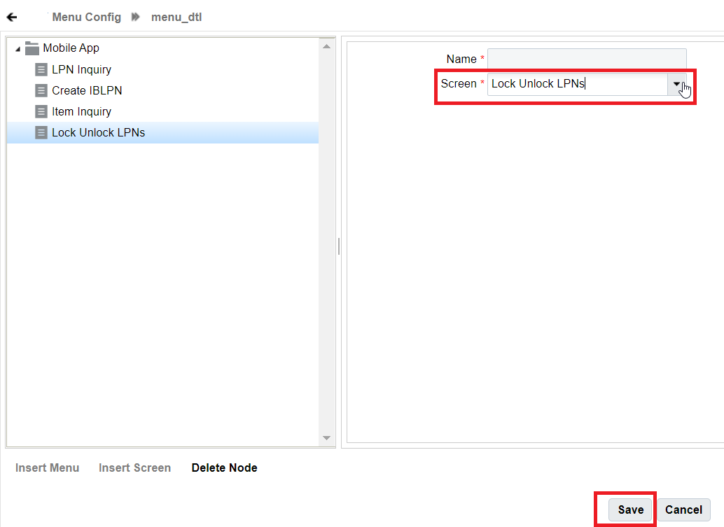

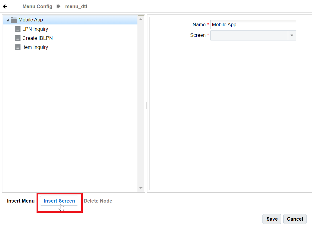

You can add module screens to the menu through one of the following ways:
- From the Menu Configuration UI > select the menu that you created and click the detail icon button.
- The menu_dtl screen opens. Click the Insert Screen
button.
- The screen drop-down is enabled for you to add the screens to your
menu. Enter the screen name and click Save button.

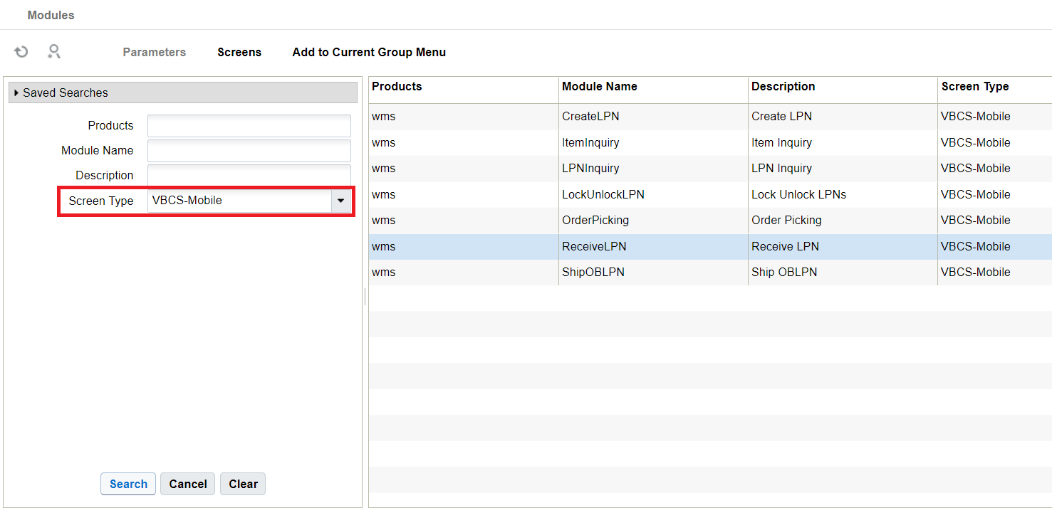

- Alternatively, you can also go to the Modules UI and search using
the Screen Type = VBCS-Mobile. The UI will display all
the available modules for that screen type.

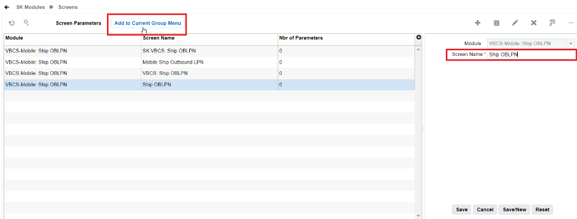

- Select a Module (Example: Ship OBLPN) and click
"Screens" button. Then, click the "+" icon to
create a new screen for the module.
- Click "Add to Current Group Menu" to add the created screen to group menu.
- Click OK to confirm the action.

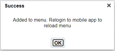

- After adding the screen successfully, the system displays the
following pop-up window. Click OK.
