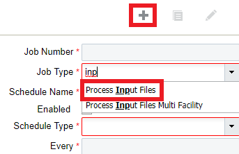

- To run the Process Input File:
- Go to the Scheduled Jobs screen, click Create (+).
- Select Process Input Files from the Job Type drop-down and populate all remaining Mandatory fields. Refer to How to Set-up Scheduled Jobs with Job Types for a list of mandatory fields.
