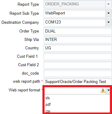

Company Report Type can summon any Web Reports template that was created from scratch using that tool. Additional configuration is also available if your current operational flow requires it. Follow the above steps if you need to create or modify a current report.
Complete the following steps for additional configuration:
- In this example, once the Report Sub Type has the WebReport value, the system allows you to use the last two fields (‘web report’ path and ‘Web report format’).
