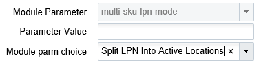

You can split LPNs into different active locations using Directed Putaway. To do this the Parameter "multi-sku-lpn-mode" must be set to "Split LPN Into Active Locations".
Multi Sku LPN Mode Parameter

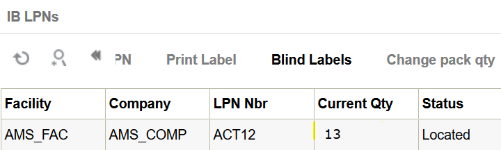

  1. Your IBLPN consist the item ACT with current qty =13.
    Note: You need to set the item’s putaway type to Active 1, so that the same SKU will appear in the IBLPN.
    Split LPN IBLPN

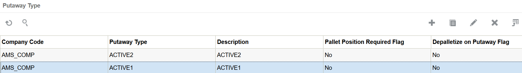

  2. Go to Putaway Type UI and define 2 putaway type ACTIVE1 and ACTIVE2.
    Putaway Type
  3. Now, configure the Putaway priority for the 2 putaway type ACTIVE1 and ACTIVE 2.

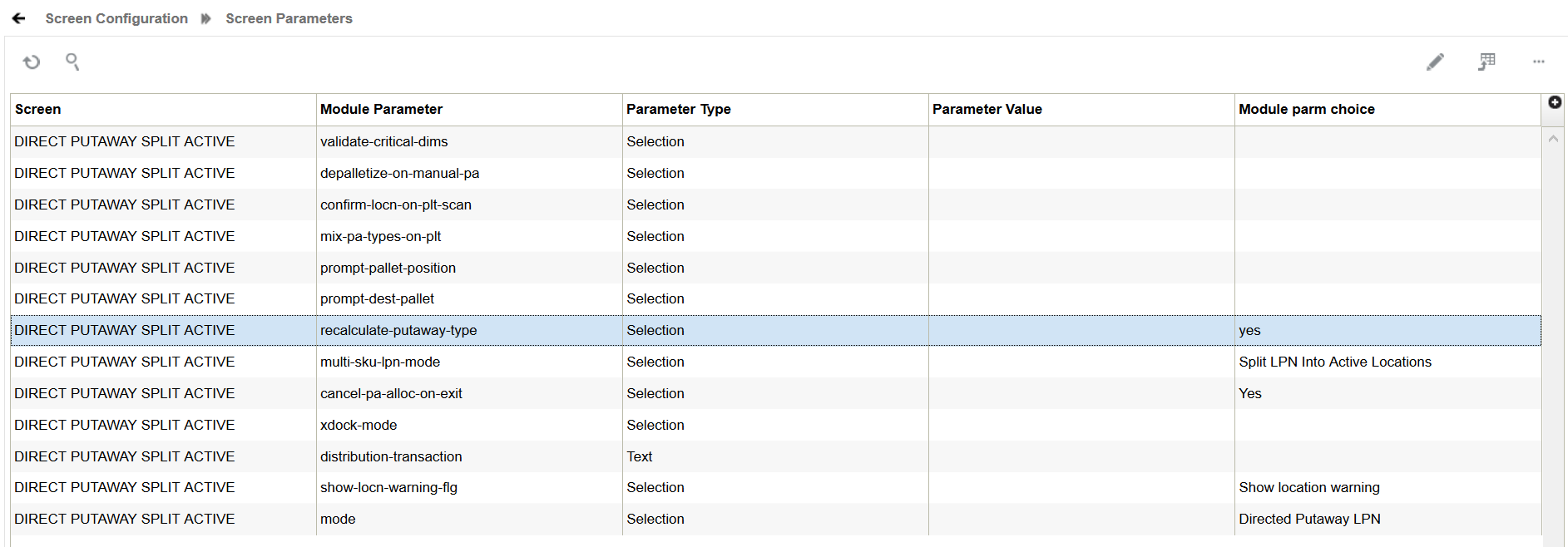

  4. Configure the directed putaway parameter:
    1. Go to Direct Putaway UI and choose "multi-sku-lpn-mode" parameter and set to "Split LPN Into Active Locations".
    2. Set the recalculate-putaway-type to Yes.
    Putaway Type Screen Parameter
    Make sure you define your item and active locations before running the transaction because the system looks for max units from the locations.

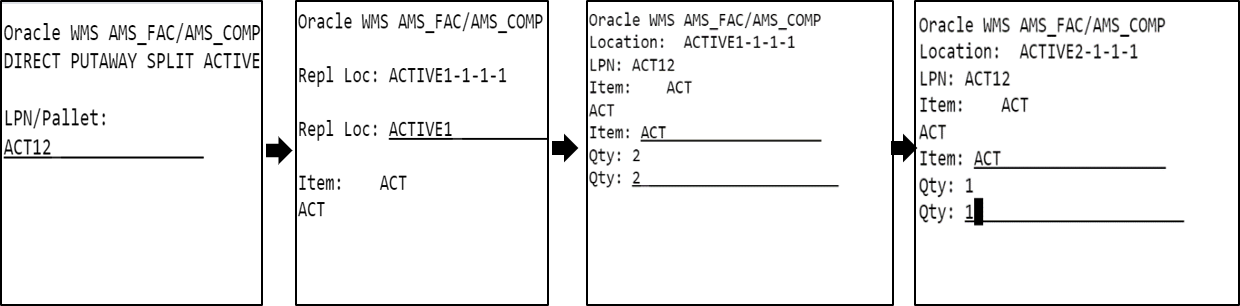

  6. Invoke the Direct Putaway transaction, the system allocates maximum units for each location.
    Putaway Transaction
    Note: On receiving the IBLPN, the putaway type Active 1 appears automatically.

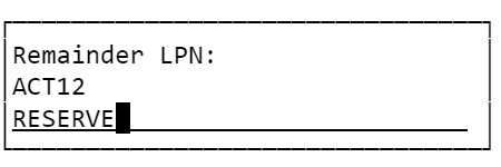

  7. You can choose to putaway the remaining units from the IBLPN into the location you choose.
    Reserve Location

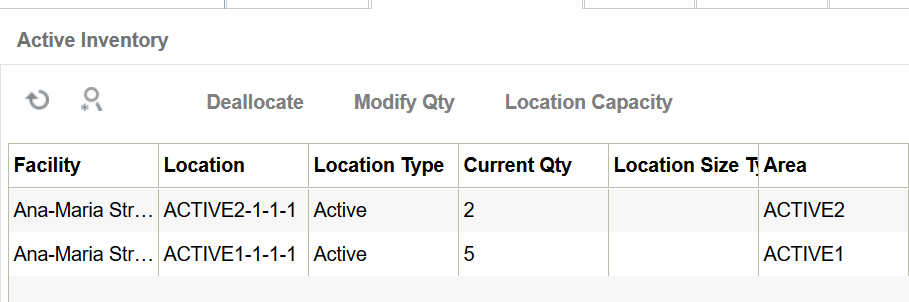

  8. To verify, go to Active and Reserve Inventory UI to view the allocation and current qty.
    Active Inventory
