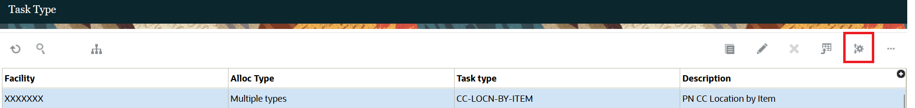

To export the configuration, do the following:
- Go to your preferred UI or screen that supports config action button (applicable UIs or screens mentioned in the above list).
- Select the records to export.Note:
- If you are not selecting any records, the system exports all data available on the screen.
- Searching for a few rows and then exporting without selecting any record will still export all data (regardless of what was searched).
- On the right corner of the UI’s table, click “config” action button.
- In the drop-down options, click “export_configuration” option.
The system prompts to save the configuration file (.cfg file format) that needs to be downloaded in the local file system.
Note: You have to enable download permissions on your browser to download and save the export configuration file. - Select the folder location and click Save.

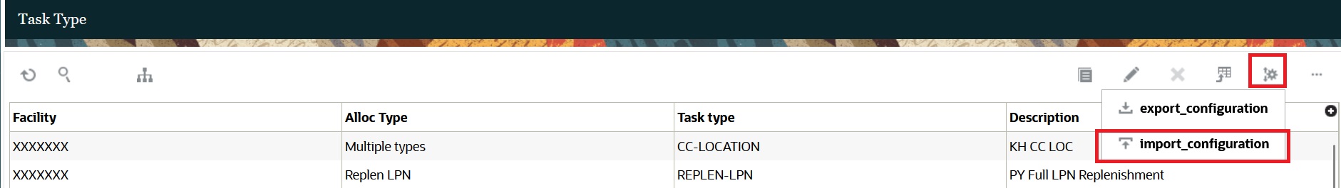

To import the configuration, do the following:
- Go to the UI or screen that supports config action button (applicable UIs or screens mentioned in the above list).
- In the drop-down options, click “import_configuration” option.
- On the pop-up screen, click “Choose Files” button.
- Then, select the previously exported configuration file and click Upload.
