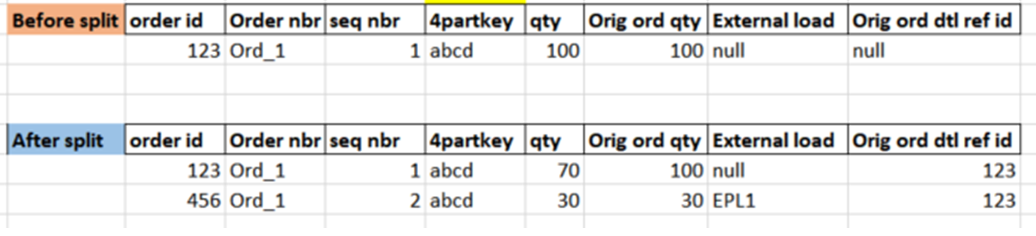

Transportation split allows you to load a single order detail to multiple loads. This trigger may come from OTM based on their loading capacity.

Based on the planned_qty, the system splits the order detail. If you skip the planned_qty entry, the system plans the load for the complete order detail quantity. Also, you can enter multiple order details to assign the load.

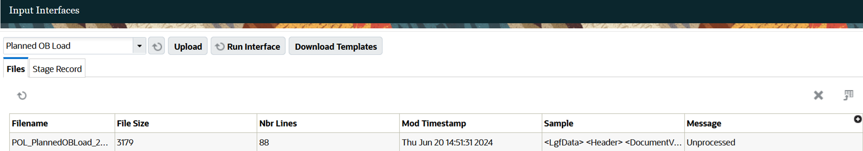

- Navigate to the Input Interfaces UI.
- Select Planned OB Load from the drop-down list.
- Click Upload and choose the saved Planned OB Load Interface .xml file.
- Click Upload.
You can observe the uploaded file under the Files tab.
- Click Run Interface to run the Planned OB Load interface file.
The system displays a pop-up message “Interface completed”. If any execution fails, the system displays an error message.
You can check the processed records under the Stage Record tab.

- If you leave “qty_uom_code” as blank, by default, the system considers the Item Primary UOM as UOM Code.
- As you are splitting the Order Detail, every time the system creates a new sequence number. So, the unique identifier here is the 4-part key (erp_source_hdr_ref + erp_source_line_ref + erp_source_shipment_ref + erp_fulfillment_line_ref).
For example, consider an order ORD-01 requires 100 quantities of SKU-1.
Order Before Planning:
Order Number | SKU | Ordered Quantity | External Planned Load Number |
ORD-01 | SKU-1 | 100 |
If you plan LOAD-1 and LOAD-2 with 50 and 20 quantities respectively via Planned OB Load Interface, the system splits the 100 quantities of ORD-01 order detail and updates the order details as follows.
ORD-01 | SKU-1 | 30 | |
ORD-01 | SKU-1 | 50 | LOAD-1 |
ORD-01 | SKU-1 | 20 | LOAD-2 |
