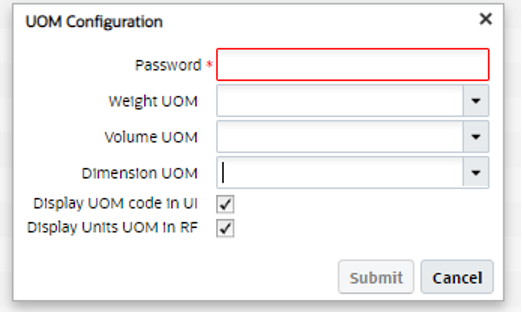

A new action button ‘UOM Configuration’ is available in the Company UI to configure UOM at the Parent Company level.
Note: The UOM Configuration button is enabled by default for the Administrator role . If you are not an admin, then you must have set up the Permission in ‘Company/Can update UOM configuration’.
This action button is only available if the selected company is a Parent Company. Parent companies have the field set up with a *. Once you configure UOM values for Weight/Volume/Dimension, the respective facilities associated with the parent company are pre-populated with same value.
UOM Configuration in Company UI
This new action button allows you to configure weight/volume/dimension UOMs.

Display Units UOM in RF:
If this flag is enabled in the Company UI, then you can configure 'Units' to be displayed in the RF screens. The flag will also display quantity fields UOM. You can also disable the flag to exclude UOM information.
  • If the UOM class is different for the item that you are scanning, the UOM associated with the item is displayed along with the quantity field.
  • If the configuration is at the parent company level, all the child companies within the same parent company will have the same setting.
  • If the selected company is a Parent company, the UOM Configuration action button is enabled and you can choose to display the UOM code in the RF screen by enabling the flag.
When new settings are carried over to the child companies associated with the parent company:
  • Child companies are not allowed to change the value UOM values.
  • If the Display Units UOM in RF box is disabled, all the child companies associated with the parent company will not display the UOM code.
The following group permission is required to access UOM Configuration:
  • company/can configure UOM configuration
