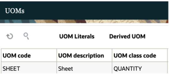

To create derived volume UOM and derived area UOM, Select the ‘Derived UOM’ action button. The following fields are available in the Create/Copy/Edit flow:
- Dimension UOM
- Derived Volume UOM
- Derived Area UOM

A child UI is available for you to configure the derived Volume UOM and Area UOM for dimension UOM class+.
