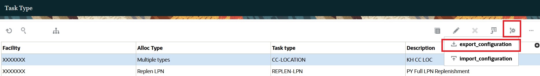

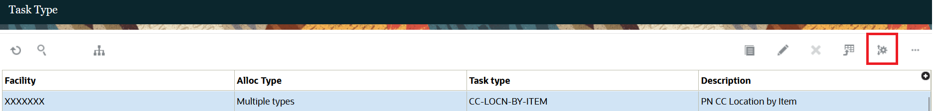

- On the right corner of the UI’s table, click “config” action button.
- In the drop-down options, click “export_configuration” option.
The system prompts to save the configuration file (.cfg file format) that needs to be downloaded in the local file system.

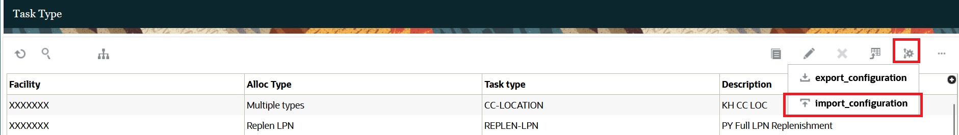

- In the drop-down options, click “import_configuration” option.
- On the pop-up screen, click “Choose Files” button.
- Then, select the previously exported configuration file and click Upload.
