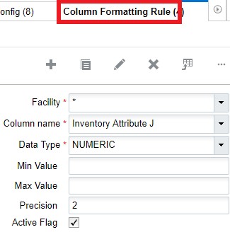

To create a formatting rule:
- From the Column Formatting Rule UI, click create.
- Select the Facility or * to apply the rule to all Facilities.
- Set the min/max value and precision.
- Select the Active Flag to enable the rule and click Save.

| UI Column | Description |
| Facility Code | User can select the facility or make it *. This drop-down will show what the logged in user is eligible for. Selecting * allows you to apply formatting rules to all associated facilities. |
| Column | List of Inventory Attributes (Drop-down) |
| Data Type | Numeric or String |
| Min Value | Applicable if the data type is Numeric. (leaving the field blank means there is no minimum value stipulated) |
| Max Value | Applicable if the data type is Numeric. (leaving the field blank means there is no maximum value stipulated). |
| Precision | Applicable if the data type is Numeric. This field does not support negative values. This field depicts the maximum precision allowed. A precision of 0 means no decimal points are allowed. |
| Active flag | Enable the active flag to activate or deactivate the rule. If the rule is not activated, then formatting rules will not be triggered. |
