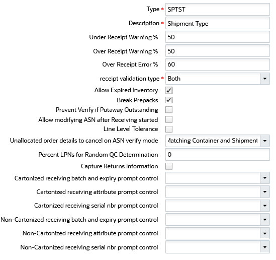

Creating Shipment Types
  1. Go to the “Shipment Types” screen and click the Create button.
  2. Check the appropriate flags for the ASN Type.
    Creating a New Shipment Type
    Description of fields
