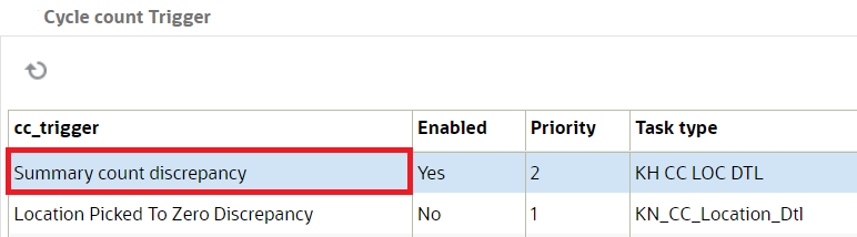

  1. Go to Cycle Count Trigger > enable ‘Summary count discrepancy’ and populate with an appropriate CC task type. Note: The parameter will be disabled by default.
    CC Trigger
  2. You can configure the Summary Count discrepancy CC trigger with either CC-LOCATION or CC-LOCATION-DTL task type. Click Save.

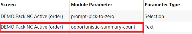

  3. Go to you picking module > screen parameter > configure opportunistic -summary-count parameter with a valid screen name of the summary cycle count module.
    Opp Summary Count
    1. When you set the parameter 'Blank', Opportunistic summary count functionality will be disabled for the associated Picking transaction.
    2. When the parameter is configured with a valid summary cycle count screen name, Opportunistic Summary Count will be enabled for the picking transaction and when inventory in a location goes below threshold value configured post picking, the summary count screen will be launched.
