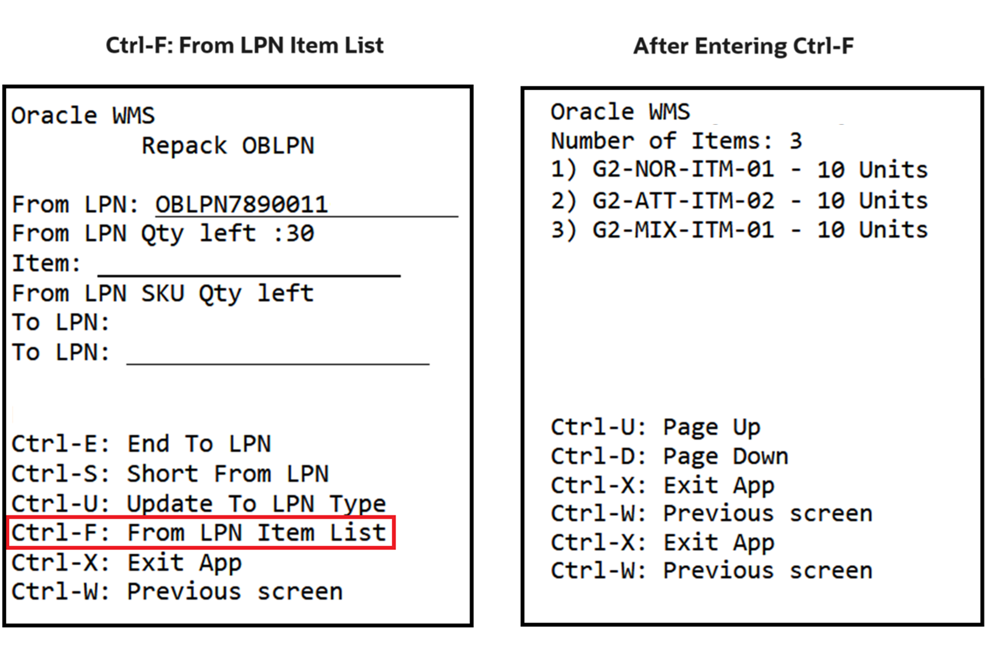

Ctrl-F Hotkey Behavior
The “Ctrl-F (From LPN Item List)” hotkey in the RF Repack OBLPN (rf.outbound.cwrfrepackoblpn) transaction displays all inventories within the source OBLPN. You can preview the unpicked items before initiating the repack, making planning efficient.
During the RF Repack OBLPN transaction, when you enter the “Ctrl-F (From LPN Item List)” hot key, the system displays the list of unpicked items in the source OBLPN with quantity and UOM (“item code” – “quantity” “UOM”).
Key Notes for Consideration
- After invoking the hot key, the system displays the list of items (unpicked) present in the OBLPN. If you pick any item during the RF Repack OBLPN transaction, the system doesn’t display the picked item in the item list again.
- The system doesn’t display the items with zero inventory.
- If the same SKU has multiple lines of attributes/batch combination, the system displays the total quantity of the SKU.
- The system displays the UOM based on the item’s Primary UOM.
