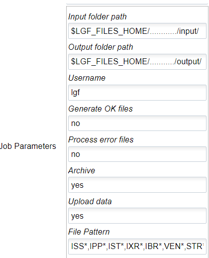

- Set up of Process Input Files: If you are using Local Oracle WMS Cloud SFTP, you
currently have this scheduled job set up. If you are setting up the new SFTP GET
scheduled job, then you can copy the input folder path (highlighted below) to
the Local directory section in SFTP GET scheduled jobs.
