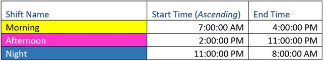

For example, let’s say that the following three shifts have been configured in WFM. User1 has a default shift defined as “Afternoon” configured in the User Master.
Shift Name
On day 1, if User1 clocks-in to the facility at 6:00 AM, the shift is determined as “Morning”. On day 2, if this user clocks-in to the facility at 8:00 AM, the shift is again determined as “Morning”. On day 3, if this user clocks into the facility at 7 PM, the shift is determined as “Night”, because 7 PM is closest to the “Start Time” of 11:00 PM."
In the table above (5 hours have already passed since shift “Afternoon” has started).
