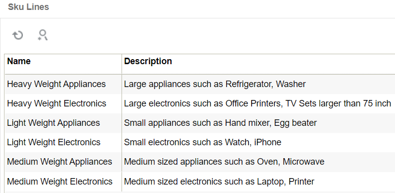

SKU Line
SKU Lines are assigned to the items in WMS in the items view. In WMS items view, the Item Line field contains the SKU Line of an item. The same SKU Lines need to be defined in WFM using the SKU Line view.
Note: WFM is not aware of Items.
SKU Lines can also be uploaded using the SKU Line interface as described in the section - Input Interfaces OR posted using SKU Line REST API as described in the section – REST APIs.
