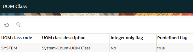

UOM Class Screen
Inventory Managers may receive different inventory from vendors in different metrics. In order to better track inventory, a new UOM Class UI has been added as a first step to start tracking inventory. This is helpful in scenarios where your vendors send you different metrics. The addition of UOM Class entity provides groupings for UOM's, so you may want to add UOMs that belong on a same Class. For example, you could have a length class, and the UOM under this class could be centemeters, meters, or feet. Or you could have a volume class, and the UOM under this class could be cubic meters, or cubic feet.
A new UI module UOMClassView is available, where Warehouse Management users can define UOM Class.=
UOM Class
Note: The System Class code indicates UOM codes that already existed in Warehouse Management prior to 22B. System class codes are not editable and you can’t add additional uom codes to this class code.
The following table provides descriptions for the fields included in the UOM Class UI:
Fields Description
UOM class_code
In the UOM Class UI, UOM Class Code allows you to define custom class codes specific to your business flow (like mass, volume, capacity, and so on.)
Note: the System class code is pre-populated and not editable. The System UOM Class encompasses Warehouse Management legacy UOMs like Packs, Units, Cases, Cubed, LPN, Pallet.
UOM Class is not specific to company. Customers with multiple companies in the same environment will see UOM Class configured.
UOM_class_description Description associated with the UOM Class code
Integer_only_flag Indicates whether the underlying UOM's associated with UOM support decimals or not. The field will not be editable for "System" UOM Class.
Predefined_flag For pre-seeded UOM's the predefined flag will be set to "true". UOM's with predefined flag will not be allowed to be edited or deleted.

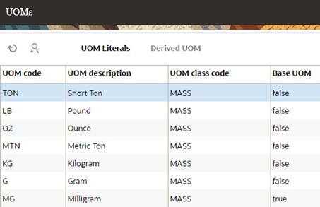

The UOM UI allows you to group and view additional UOMs that belong together in the same UOM Class.
In the following example, you can see all of the different UOM codes (measurement categories) that have been grouped as MASS:
UOM Grouped as Mass

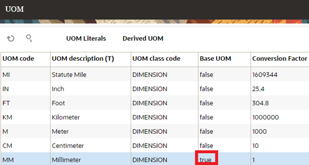

Base UOM This field should be Set to True for the base UOM and False for the other UOMs in the same UOM class.
Conversion Factor You can view the conversion factor of the UOMs with respect to the base UOM.

Note: The base UOM for the system class UOM is Units. The corresponding conversion factor for other UOMs is based on the system class UOM = 1.
For example, where the UOM is 1 Millimeter, the corresponding conversion factor for Centimeter is 10.
