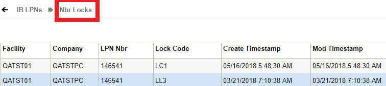

You can add specific Lock Codes to an IBLPN by clicking the blue number value in the “Nbr Locks” column:
This will prompt a new window, where you can add multiple lock codes to the container:

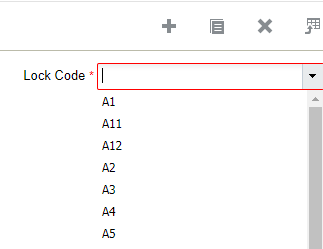

The above figure shows all the Lock Codes currently added to the container. Click Create () and select one of the configured Lock Codes from the drop-down to add lock codes.

- Select the LPNs that you can want to apply or remove a lock code.
- On applying the lock codes, the system displays a Confirmation pop-up window on updating the number of LPNs to be locked or unlocked.
- After you click OK to proceed, you will be provided with a list of available Lock Codes that you can apply.
