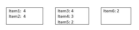

The current cubing feature of WMS employs an algorithm that relies on strict ordering and capacity checks. For example, a configuration which orders by item barcode, allowing for up to three distinct items per LPN and targeting an LPN type with a max volume of 10 would yield the following results:
Configuration by Item Barcode
Resulting LPN utilization:
- LPN1: 80%
- LPN2: 90%
- LPN3: 20%
You will notice that a third LPN is required due to the algorithm preserving a strict ordering. By removing the requirement of strict ordering, the new cubing modes will now employ a constraint model that enforces a constraint “no more than three distinct items per LPN.”
