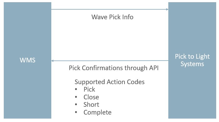

In a Pick to Light (PTL) flow, after WMS Cloud runs a wave and creates allocations, these are then communicated to the PTL system. The PTL will have information on each allocation, container, location and item quantities to be picked.
As a container is scanned at the start of the picking module, lights light up corresponding to the allocations in that container. As the operator pushes the light buttons to confirm picks, the PTL system sends messages. Once the container is complete, a close message is received from the PTL and the container can proceed to staging. Exception scenarios such as short picks are also covered through these APIs.

Wave Load Balancing Flow
The following table indicates the order and actions involved in a typical Wave Load Balancing flow:
| Step | Description |
| 1 |
Wave Load Balancing – wave group has order selection and capacity to create balanced waves
| 2 | WMS sends Wave Pick Information message |
| 3 |
Pick to Light System receives Wave Pick Information message |
| 4 |
Pick and Packing is performed using Pick to Light System |
| 5 |
Pick to Light system makes an API call when Picks are performed |
| 6 |
WMS updated with pick and pack information |
This flow diagram illustrates the Wave Pick Information being sent to the Pick to Light System and the Pick to Light System generating and API call to WMS as picks are confirmed. WMS then performs the pick and pack updates:
