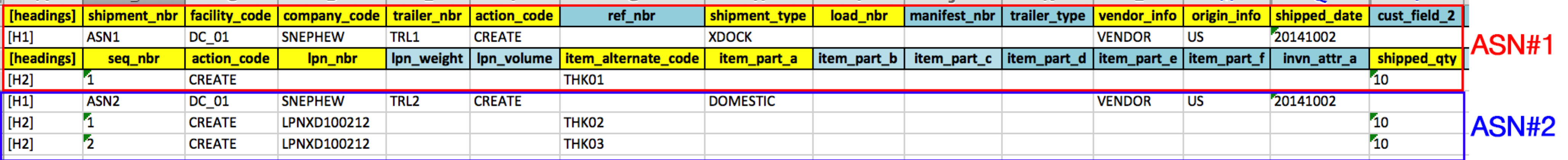

- Populate [H1] for every distinct ASN number and [H2] for its details (see figure below).
- Populate the correct sequence in the ‘seq_nbr’ field (i.e. no duplicate
values).
The figure above is an example of a file that will create two different ASNs. Users can create multiple ASNs within the same ISS file by using the “headings” column to differentiate one ASN record from another. A ‘[H1]’ value denotes a new ASN Header record, while a ‘[H2]’ value denotes a new ASN Detail record.
