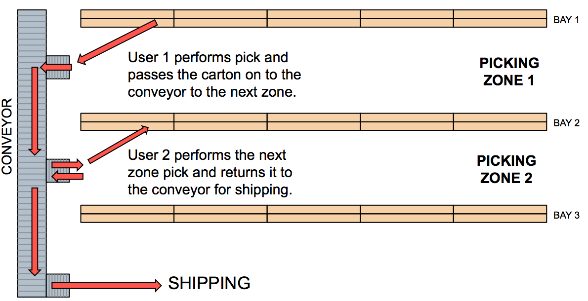

Zone Picking
Zone Picking is a method of order picking that divides items into multiple zones, where each employee is trained to pick within an assigned zone.
The following figure shows an example of Zone Picking:

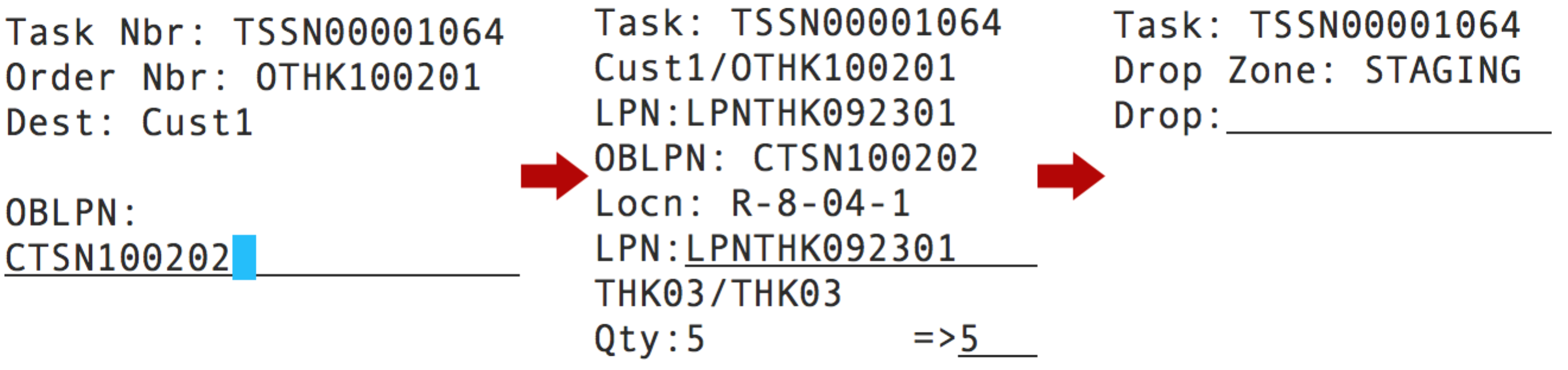

Executing Pick Zone Tasks in the RF
Pick Zone tasks behave very similarly to normal tasks. The only difference is that at the end of every zone pick, the RF will automatically prompt you to leave the picked LPN at an intermediate drop location (eg. a conveyor). The second picker will then intercept this LPN and continue the picking process until the task is complete.
- Enter the “Execute Task” RF module and enter the pick zone task.
- To begin picking, the RF will prompt you with an OBLPN to pack the merchandise to.
- One the OBLPN is initiated, the picking process will begin. The RF will direct you to a pick location and ask you to scan the IBLPN and quantity.
- When all the picks for the first zone are complete, the RF will prompt you for the intermediate drop location. You must scan the drop location to confirm that the OBLPN is dropped off.
- When the second operator arrives to continue the pick, you must press Ctrl-P within the “Execute Task” module. This will prompt you to scan a Task or Container number. Scan the OBLPN.
- At this point, the picking process will repeat itself until the LPN reaches the
last pick zone and all of the units are picked. When the last pick is complete,
the RF will prompt you for a destination zone (if configured).
- When the task is complete, the RF will return to the Task list.
