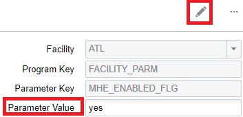

- Search for the parameter key MHE_ENABLED_FLG.
- Click Edit, and set the Parameter Value to Yes.

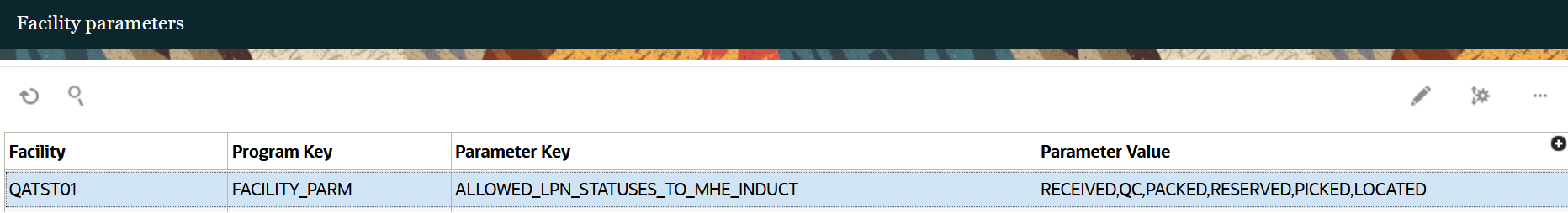

- For the facility parameter ALLOWED_LPN_STATUSES_TO_MHE_INDUCT set up the value with all of the LPN statuses that are used in MHE.
Allowed statuses include the following:
RECEIVED,QC,PACKED,RESERVED,PICKED,LOCATED
