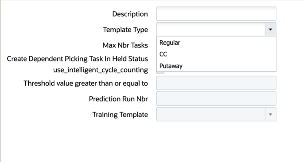

  • Navigate to Task Creation Template and select Putaway as the template type.
  • Set up task settings for PUTAWAY_CART by configuring Ordering Criteria and Zone Movement Rules.
Task Creation Template: Putaway
