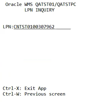

- Go to RF LPN Inquiry screen.
- Enter or scan an LPN or Container Number.

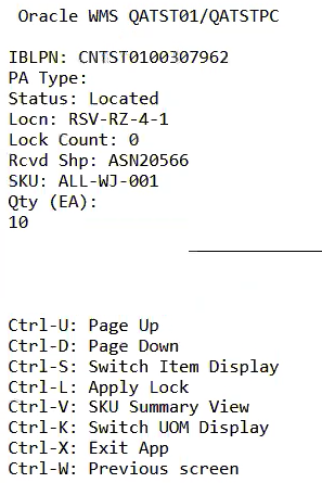

Based on the screen parameter configuration, the system displays multiple details of LPN. The details vary for IBLPN and OBLPN.
- If you scan an IBLPN, the system displays the following details.
- Putaway Type
- Container Status
- LPN’s current location
- Lock code count
- Received Shipment Number
- SKUs that are part of LPN
- SKU’s quantity along with UOM
- SKU’s inventory attributes, expiry date, or batch number (if SKU is tracking these and RF screen parameters are configured to display these)

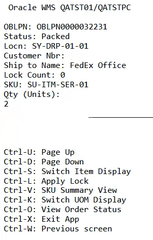

Note: If the scanned LPN is a multi-SKU LPN, hit “Ctrl+D” hot key to view the remaining inventory line (SKU) details. - If you scan an OBLPN, the system displays the following details.
- Container Status
- Ship-To Facility code (for facility order or store order)
- Customer Number (for customer order)
- Ship to Name (for customer order)
- Lock code count
- Pallet Number
Note: While inquiring an LPN, the system displays inventory lines with Current Quantity = 0 in any Container Status, because of the following reasons:- To keep the historical track of LPN inventory lines that are modified to Cancelled/Consumed status with current quantity = 0.
- OBLPNs in “Outbound Created” status may have in-transit quantities with current quantity = 0.
