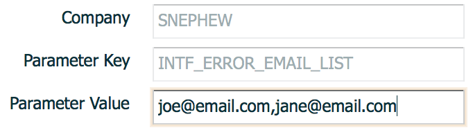

- Go to the “Company Parameters” screen.
- Select “INTF_ERROR_EMAIL_LIST” parameter and click Edit.
- In the “Parameter Value”, populate the emails that will receive the error
notifications. Separate multiple emails without spaces between emails.
